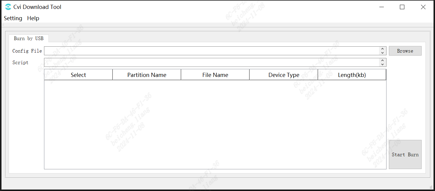

Step1.1
Start cviDownloadTool, Enter the visual interface.
../_images/cviDow000.png
Fig. 3.4 Cvi Download Tool interface

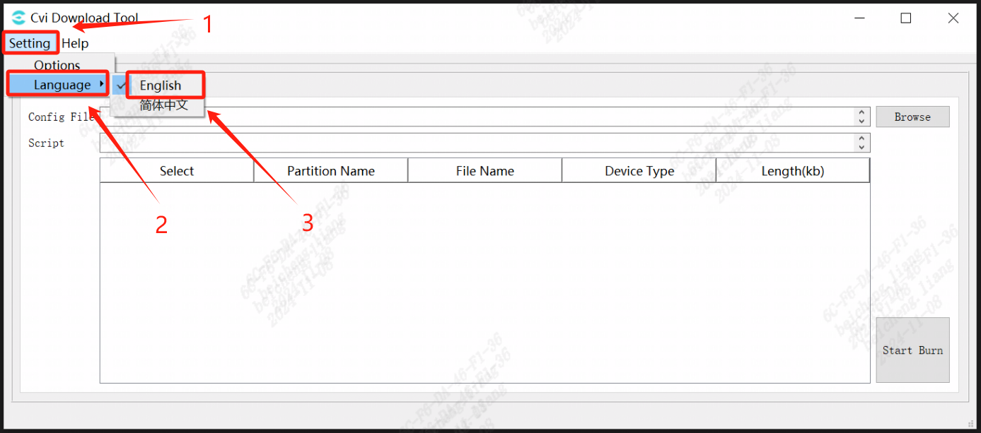

Step1.2
Click Setting->Language to select the language.
../_images/cviDow001.png
Fig. 3.5 Cvi Download Tool language switch
