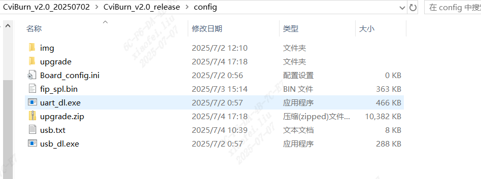

Open a cmd command window in the tool’s directory and extract the upgrade.zip archive to the same folder.
../_images/驱动路径.png
Fig. 3.16 Location of usb_dl.exe and uart_dl.exe
Usage of usb_dl.exe and uart_dl.exe
  1. usb_dl.exe - usb_dl.exe -c <CHIP> -i .upgrade
  2. uart_dl.exe - uart_dl.exe -c <CHIP> -p COM3 -i .upgrade
