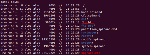

fip.bin is obatained from the install/<board name> directory:
$ ls -al  install/soc_cv1820_wevb_0005b_spinand
../_images/1.png

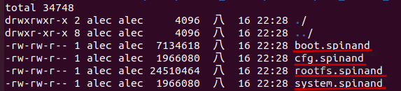

*.spinand is obtained from install/<board name>/rawimages:
$ ls -al  install/soc_cv1820_wevb_0005b_spinand/rawimages
../_images/2.png
Attention
Note: *.spinand in the rawimages subdirectory is the raw images used by the burner. The *.spinand in the directory on the upper level is a special format for the CVITEK SD card/USB update tool, and an additional 128 bytes header is added based on the bare image.
