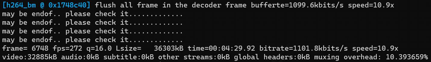

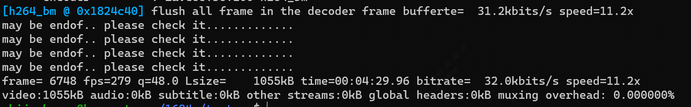

1684
transcode
转 32K 低码流:
1ffmpeg -hwaccel bmcodec -hwaccel_device 0 -c:v h264_bm -output_format 101 -i test.264 -vf "scale_bm=352:288" -c:v h264_bm -g 256 -b:v 32K -y result.264
../_images/1684_transcode_1.png
转 1Mbps 高码流:
1ffmpeg -hwaccel bmcodec -hwaccel_device 0 -c:v h264_bm -output_format 101 -i test.264 -vf "scale_bm=352:288" -c:v h264_bm -g 256 -b:v 1M -y result.ts
../_images/1684_transcode_2.png

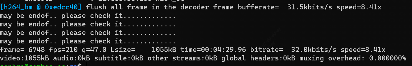

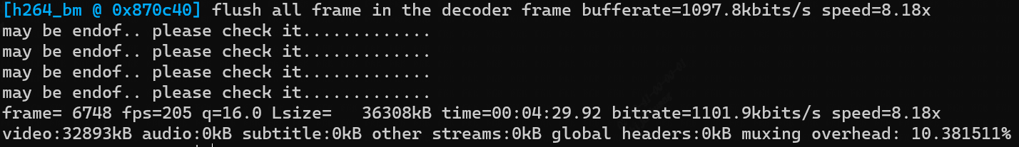

1684X
transcode
转 32K 低码流:
../_images/1684x_transcode_1.png
转 1Mbps 高码流:
../_images/1684x_transcode_2.png
