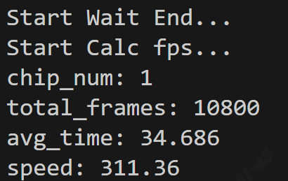

7.2.1. 视频解码性能测试
测试命令
#!/bin/bash
video=jellyfish-3-mbps-hd-h264.mkv
tpu_id=0
thread_num=16
decode_type=h264_bm
rm -rf *.log
rm -rf fpssum.txt  fps.txt  framesum.txt  frame.txt  speed.txt  timeavg.txt  timesum.txt  time.txt
killall ffmpeg &> /dev/null
for ((thread=0; thread<$thread_num; thread++))
do
        nohup ffmpeg -benchmark -extra_frame_buffer_num 5 -output_format 0 -zero_copy 1 -sophon_idx ${tpu_id} -c:v ${decode_type} -i $video  -f null /dev/null >> ${video}_thread_${thread}_tpu_${tpu_id}.log 2>&1 &
done
echo "Start Wait End..."
while true; do
    ffmpeg_num=$(ps aux | grep ffmpeg | grep -v "grep" | wc -l)
    echo "running ffmpeg num: ${ffmpeg_num}"
    if [[ "$ffmpeg_num" == "0" ]]; then
            break
    fi
    sleep 3
done
echo "Start Calc fps..."
do
    frame_index=0
    for((a=1; a<20; a++))
    do
        str=$(cat ${video}_thread_${thread}_tpu_${tpu_id}.log | tail -n ${a}|head -n 1)
        # echo $str
        keyword=$(echo $str |grep "frame=")
        # echo $keyword
        if [[ $keyword != "" ]];
        then
        frame_index=${a}
        break
        fi
    done
    time_index=0
    do
            # echo $str
            keyword=$(echo $str |grep "rtime=")
            # echo $keyword
            then
                time_index=${a}
                break
            fi
    done
    cat ${video}_thread_${thread}_tpu_${tpu_id}.log | tail -n $frame_index|head -n 1| awk -F '=' '{print $3}'|tr -d 'a-z'|tr -d ' ' >> fps.txt    #fps
    cat ${video}_thread_${thread}_tpu_${tpu_id}.log | tail -n $frame_index|head -n 1| awk -F '=' '{print $2}'|tr -d 'a-z'|tr -d ' ' >> frame.txt    #frames
    cat ${video}_thread_${thread}_tpu_${tpu_id}.log | tail -n $time_index|head -n 1| awk -F '=' '{print $4}'|tr -d 'a-z'|tr -d ' ' >> time.txt    #frames
    cat fps.txt | awk '{sum+=$1} END {print sum}' > fpssum.txt
    cat frame.txt | awk '{sum+=$1} END {print sum}' > framesum.txt
    cat time.txt | awk '{sum+=$1} END {print sum}' > timesum.txt
done
echo "tpu_id: $tpu_id"
echo "total_frames: $(<framesum.txt)"
task_num=$(cat frame.txt | grep "." -c)
cat timesum.txt | awk '{print $1/'$task_num'}' > timeavg.txt
echo "avg_time: $(<timeavg.txt)"
f_sum=$(<framesum.txt)
time_avg=$(<timeavg.txt)
awk 'BEGIN{printf "%.2f\n",'$f_sum'/'$time_avg'}' > speed.txt
speed=$(<speed.txt)
echo "speed: ${speed}"
参数说明
  • tpu_id: 测试的智能视觉深度学习处理器的编号,可以通过bm-smi查看。
  • thread_num: 解码线程数,一般可设置为16。
  • decode_type: 解码方式,如h264_bm,hevc_bm ,分别代表h264和h265。
典型测试结果
深度学习处理器
场景
测试结果(其中avg_time单位为秒,speed单位为fps)
1684
decode
../_images/1684_decode.png
1684X
decode
../_images/1684x_decode.png
小技巧
测试脚本 中包含了多芯卡的测试程序’decode_multicard.sh’,通过修改里面的’tpu_ids’可实现对多芯卡的视频解码测试。

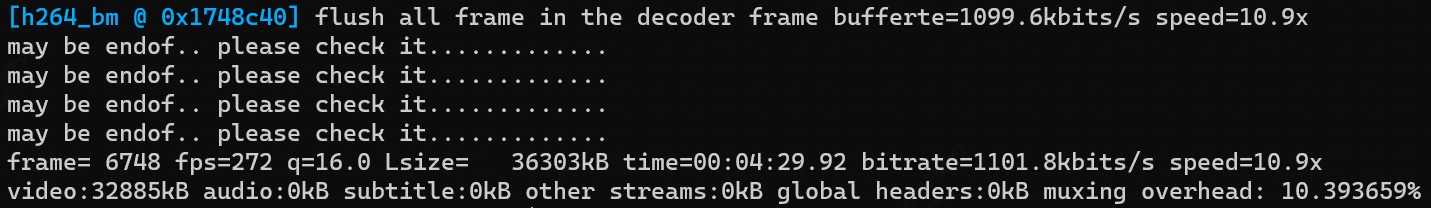

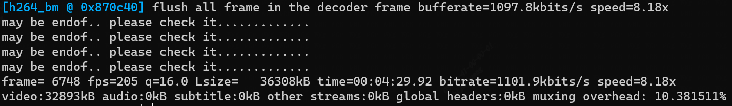

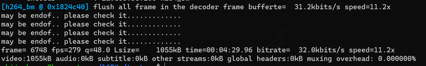

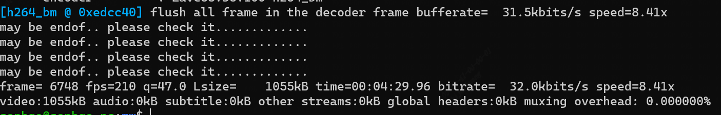

7.2.3. 视频转码性能测试
生成转码所需要的原始视频
ffmpeg -i jellyfish-3-mbps-hd-h264.mkv -c copy -bsf:v h264_mp4toannexb -f mpegts 1.264
ffmpeg -i "concat:1.264|1.264|1.264|1.264|1.264|1.264|1.264|1.264" -c copy -bsf:a aac_adtstoasc -movflags +faststart test.264
转32K低码流
ffmpeg -hwaccel bmcodec -hwaccel_device 0 -c:v h264_bm -output_format 101 -i test.264 -vf "scale_bm=352:288" -c:v h264_bm -g 256 -b:v 32K -y result.264
转1M高码流
ffmpeg -hwaccel bmcodec -hwaccel_device 0 -c:v h264_bm -output_format 101 -i test.264 -vf "scale_bm=352:288" -c:v h264_bm -g 256 -b:v 1M -y result.ts

典型测试结果
深度学习处理器 | 场景 | 测试结果
1684
转 32K 低码流
../_images/1684_transcode_1.png
转 1M 高码流
../_images/1684_transcode_2.png
