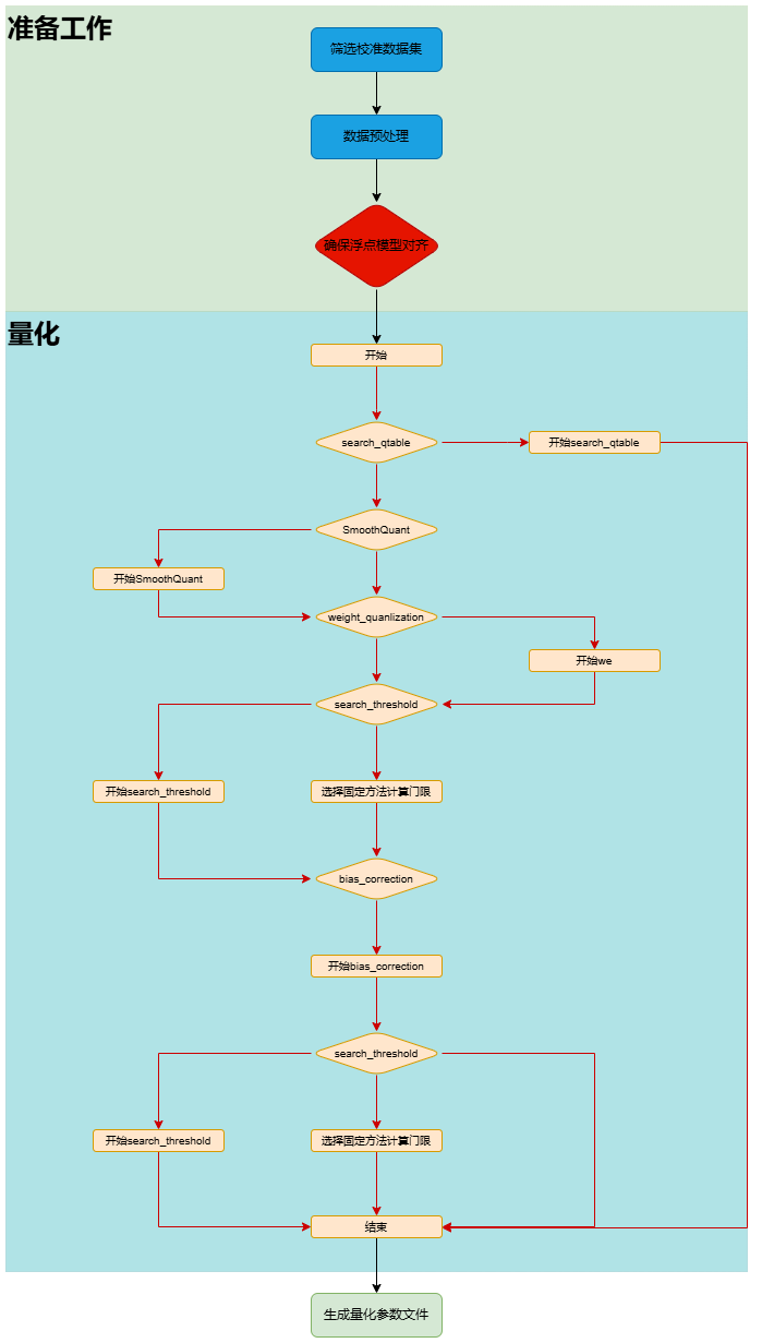

7.1.1. run_calibration Process Introduction
The quantization part of the following figure (:ref:calibration) shows the overall process of the current run_calibration , which includes the automatic mixed-precision module search_qtable , the automatic calibration method selection module search_threshold , cross-layer weight equalization module weight_equalization,
and bias correction module bias_correction, etc. In the following sections, we will provide the usage details of the above methods based on actual situations.
Fig. 7.1 run_calibration process
