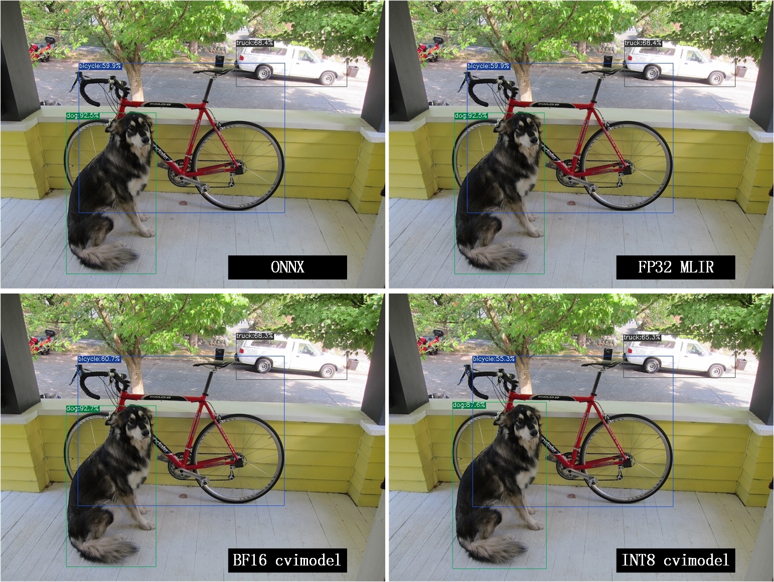

12.1.6. Result Comparison
The onnx model is run as follows to get dog_onnx.jpg:
The FP32 mlir model is run as follows to get dog_mlir.jpg:
    --model yolov5s.mlir \
The BF16 cvimodel is run as follows to get dog_bf16.jpg:
    --model yolov5s_cv183x_bf16.cvimodel \
The INT8 cvimodel is run as follows to get dog_int8.jpg:
    --model yolov5s_cv183x_int8_sym.cvimodel \
The comparison of the four images is shown in Fig. 12.1, due to the different operating environments, the final effect and accuracy will be slightly different from Fig. 12.1.
_images/yolov5s_cvi.jpg
Fig. 12.1 Comparing the results of different models
The above tutorial introduces the process of TPU-MLIR deploying the ONNX model to the CV18xx series processors. For the conversion process of the Caffe model, please refer to the chapter “Compiling the Caffe Model”. You only need to replace the processors name with the specific CV18xx processors.
