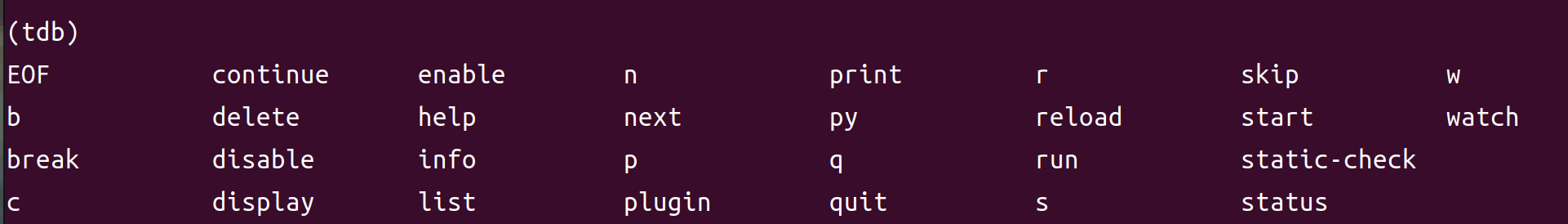

After entering TDB, press tab twice to get the command prompt. The display looks like this:
_images/tdb_tab.png
After entering TDB, the following commands can be used:

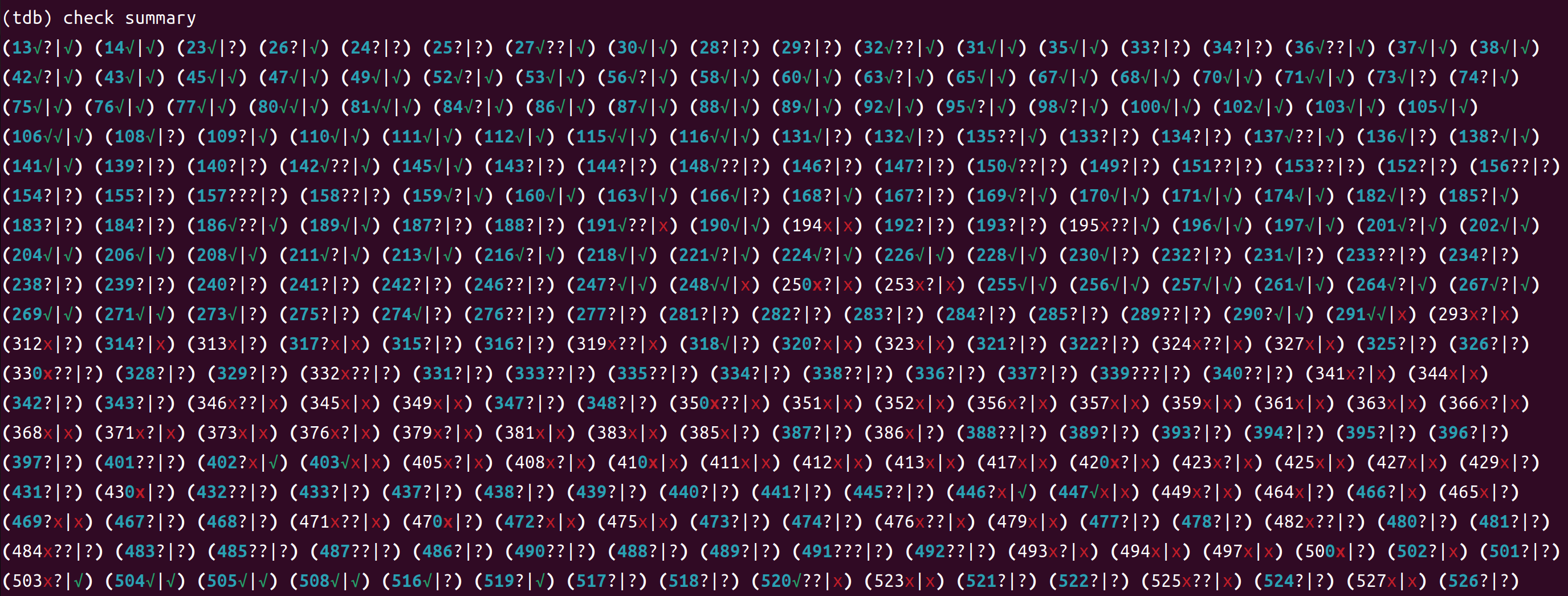

Cache mode, with three options: online, offline, generate. Default is online.
To use bmodel_checker you need to enter the Context directory, as shown in the following example:

After outputting the check report, it automatically enters the interactive mode. The interactive mode provides a detailed view of the errors and also allows you to quickly jump between lines, as shown in the following example of a cswin_tiny model.

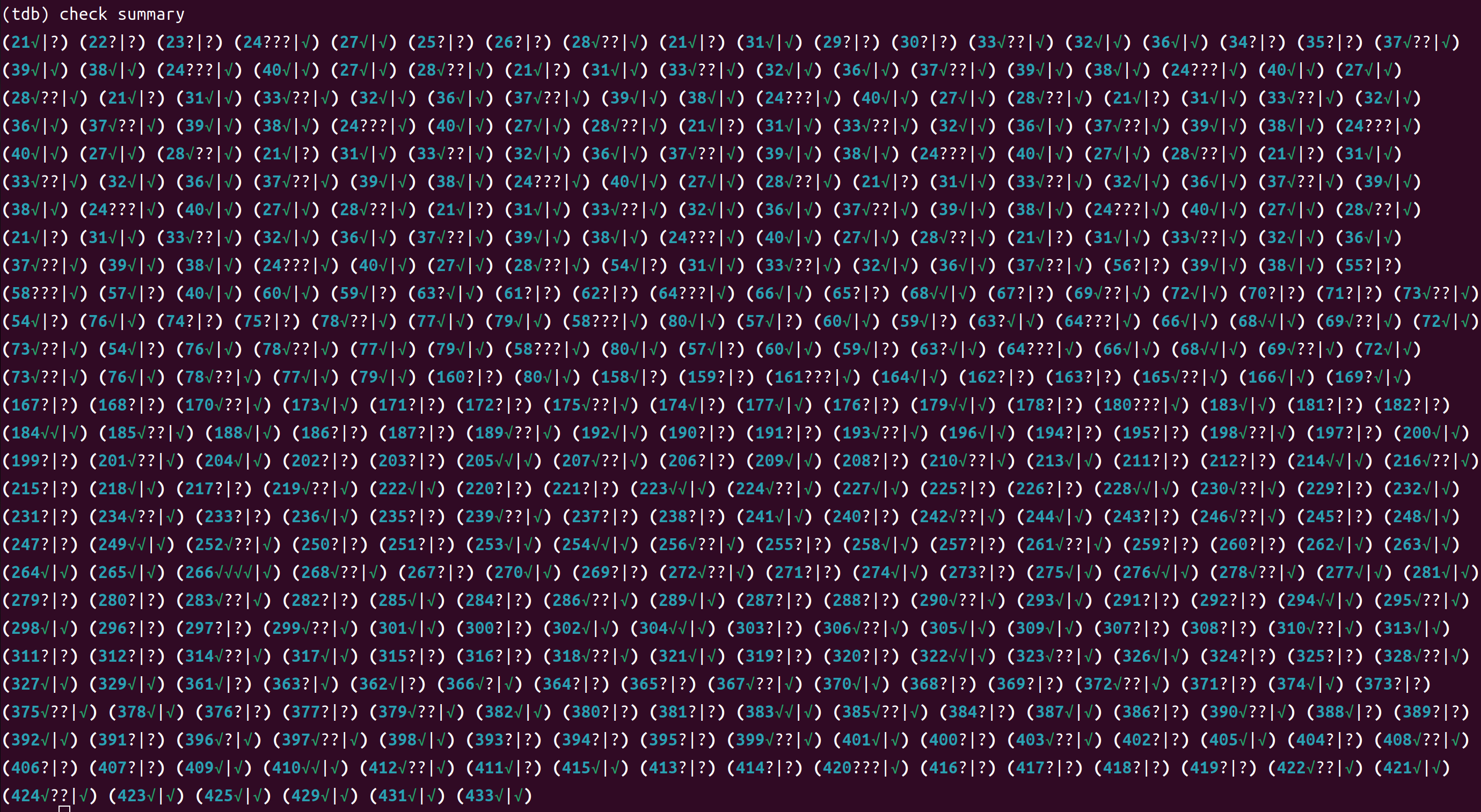

check summary
The check report can be reprinted by using the check summary command:
_images/tdb_check_summary_cswin.png
It is worth noting that you can aggregate inputs and outputs with the same line numbers using the check summary reduce command.

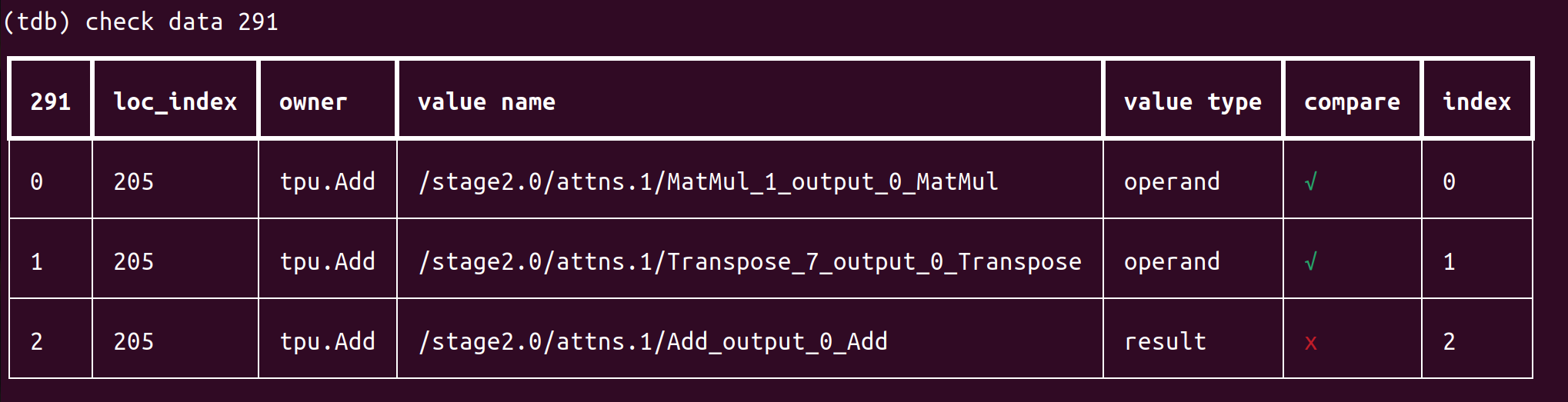

check data
(tdb) check data [file-line]
where file-line is the line number in the checker report, which corresponds to the line number of final.mlir . This command gives a description of all the input and output data of the command corresponding to file-line, an example is shown below:
_images/tdb_check_data_1.png

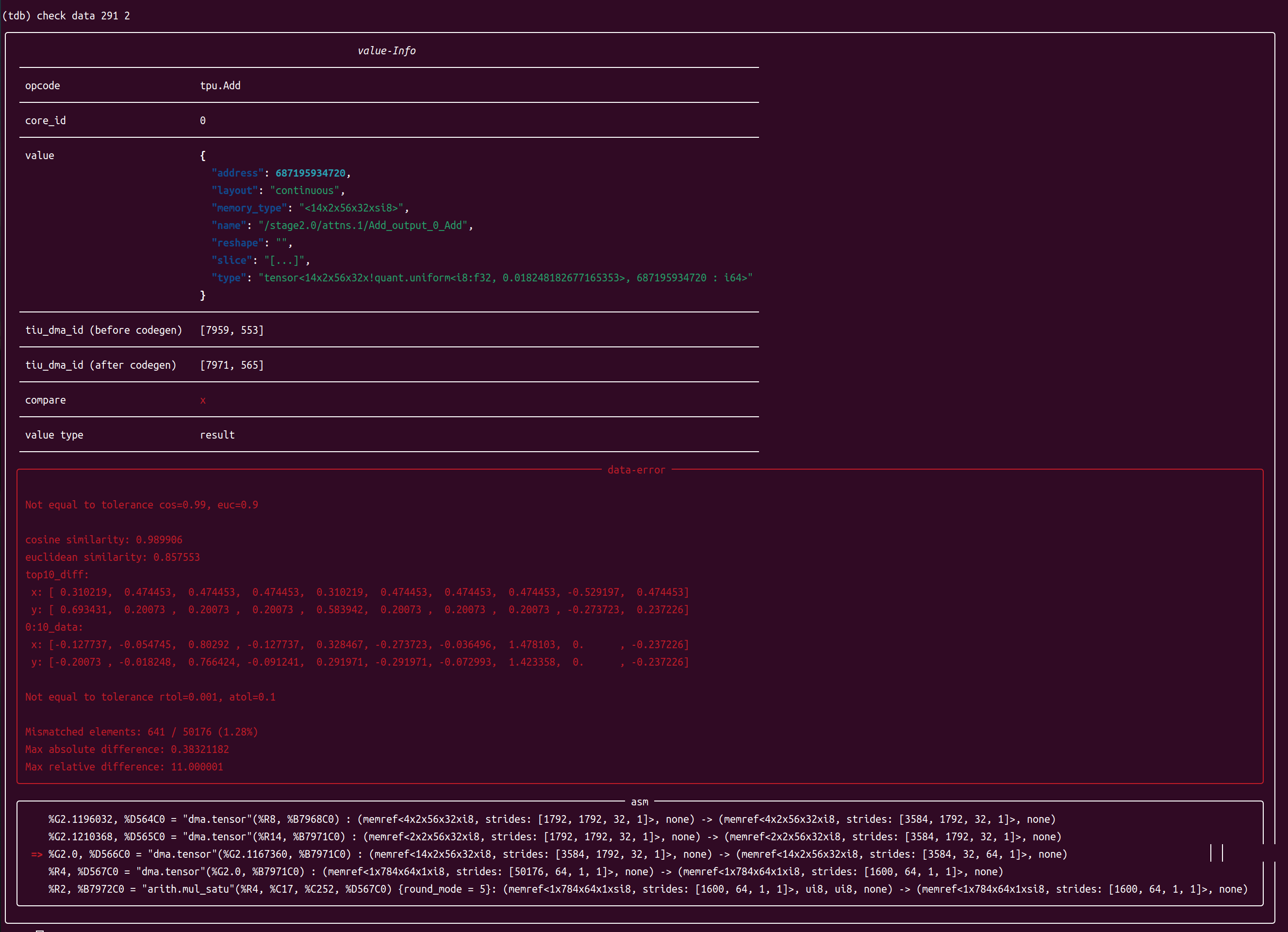

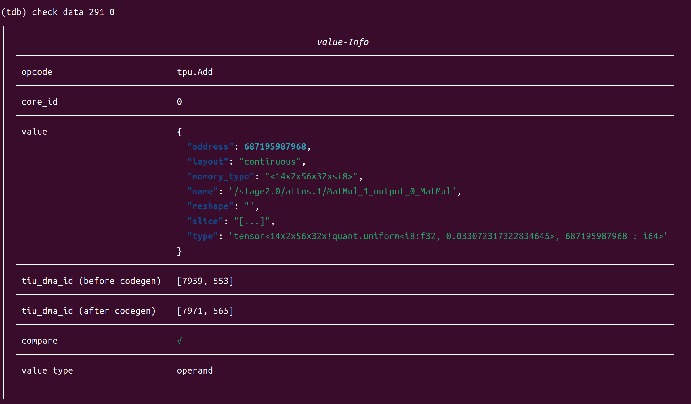

(tdb) check data [file-line] [index]
Where index is the index of the data output by the check data [file-line] command. This command gives detailed information about the corresponding index data, and an example of comparing the correct data is shown below:
_images/tdb_check_data_2.png
An example of comparison error data is shown below:
_images/tdb_check_data_3.png
