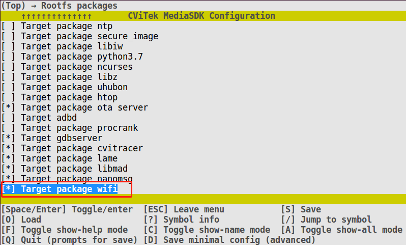

Select Rootfs packages -> Target package wifi and turn on the wireless through the menu mode, archive away and start compiling

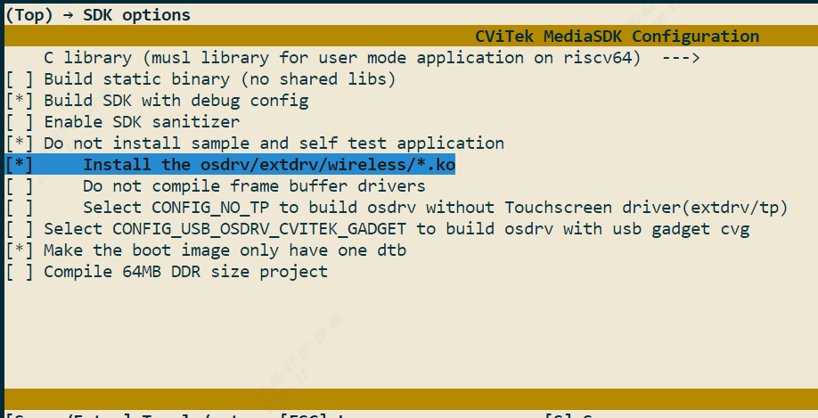

Or edit build/boards/{processor_name}/{board_name}/{board_name}_defconfig to enable the following options (as shown below), then execute defconfig $CHIP_$BOARD through command mode to automatically configure
# Rootfs packages
CONFIG_TARGET_PACKAGE_WIFI=y
CONFIG _CP_EXT_WIRELESS=y
# end of Rootfs packages
