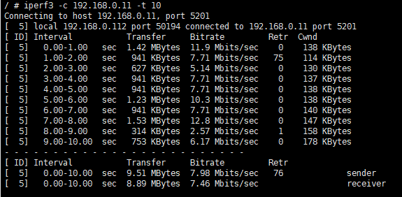

_images/Tests002.png
The results can be obtained through iperf3 sending test, as shown in the figure above. The meaning of each parameter can be explained by executing “iperf3 -h”.
It can be seen from the above figure that the average throughput of 10 seconds is 7.98 Mbps.
