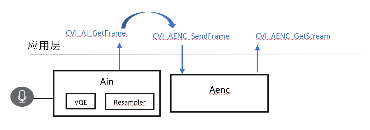

User-Get Mode : |
Advantage: SDK users can obtain and record the status of each audio frame, and users can perform operations such as drop / delay / copy at the application layer. Disadvantages: SDK users need to open threads to do get/send actions at the application layer. |

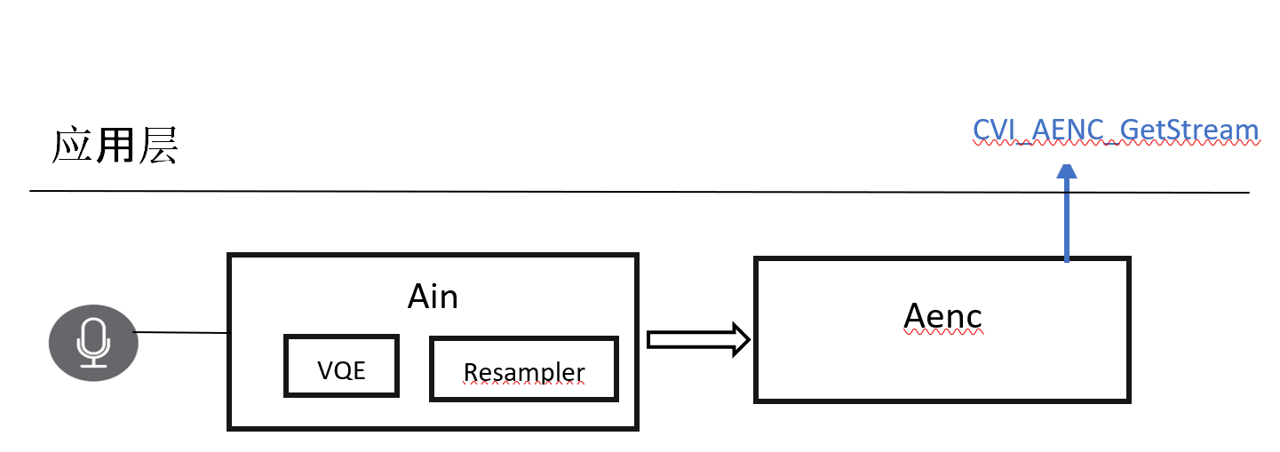

Bind Mode : |
Advantages: SDK users only need to be responsible for fetching or broadcasting data after creating channel parameters. Disadvantage: The application layer cannot deploy and observe the current state. |
Uplink Audio (from microphone to encoding)
Reference source: cvi_sample_audio.c : SAMPLE_AUDIO_AiAenc
The diagram above illustrates the User-Get Mode.
The diagram above illustrates the Bind Mode.

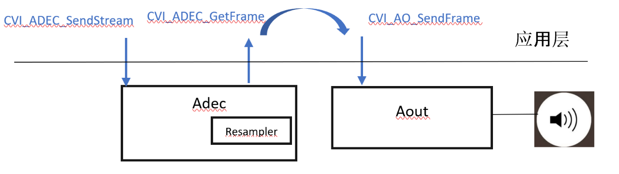

Downlink Audio (from decoding to playback):
Reference source: cvi_sample_audio.c : SAMPLE_AUDIO_AdecAo

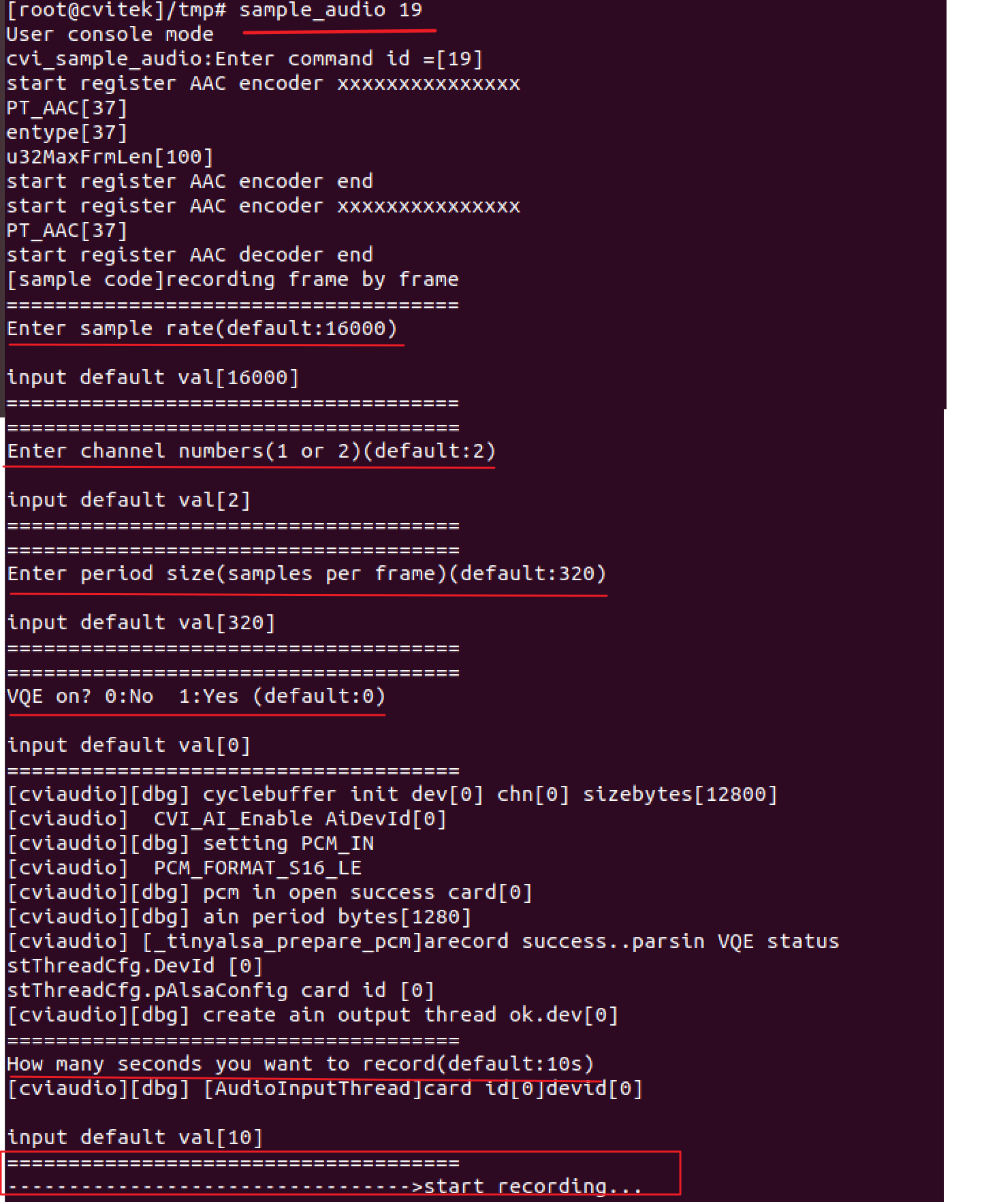

[Example Code for Recording]:
When running
sample_audio 19,
it corresponds to the code flow in case 19 of cvi_sample_audio.c.
The program prompts the user to enter recording parameters, and the user can simply press Enter to use the default values (as shown in the figure below).
When the console displays: ———————————>start recording…
Recording will begin for the specified number of seconds according to the user’s settings, and the audio will be saved as “sample_record.raw” on disk.

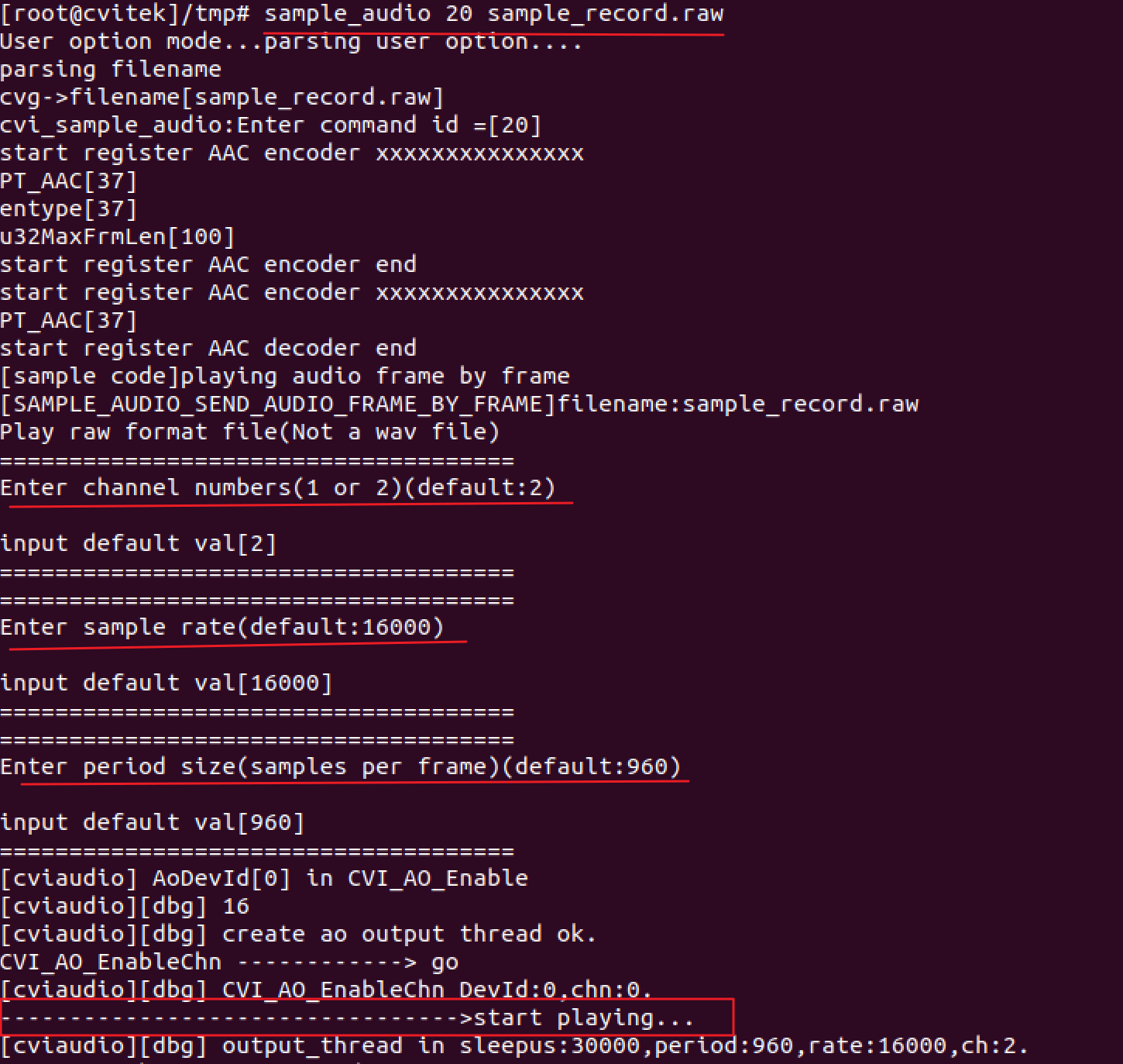

[Example Code for Playback]:
When running
sample_audio 20 檔名.raw,
it corresponds to the code flow in case 20 of cvi_sample_audio.c.
The program prompts the user to enter playback parameters, and the user can simply press Enter to use the default values (as shown in the figure below).
When the console displays: ———————————>start playing… Playback will begin based on the user’s configuration and file name.
