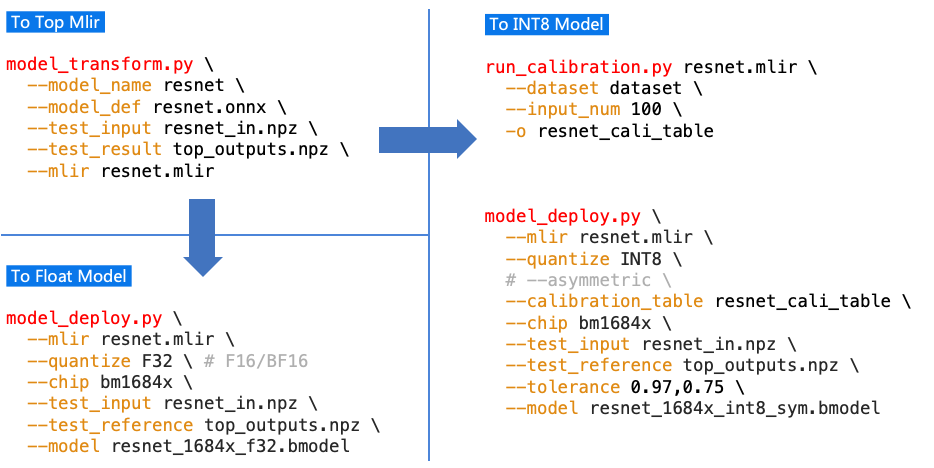

The basic procedure is transforming the model into a mlir file with model_transform.py, and then transforming the mlir into the corresponding model with model_deploy.py. Calibration is required if you need to get the INT8 model. The general process is shown in the figure (User interface 1).
Other complex cases such as image input with preprocessing and multiple inputs are also supported, as shown in the figure (User interface 2).

_images/ui_0.png
Fig. 3.1 User interface 1
_images/ui_1.png
Fig. 3.2 User interface 2
