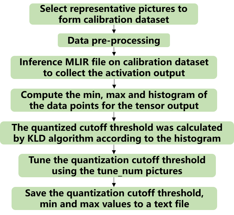

Calibration is the use of real scene data to tune the proper quantization parameters. Why do we need calibration? When we perform asymmetric quantization of the activation, we need to know the overall dynamic range, i.e., the minmax value, in advance. When applying symmetric quantization to activations, we need to use a suitable quantization threshold algorithm to calculate the quantization threshold based on the overall data distribution of the activation. However, the general trained model does not have the activation statistics. Therefore, both of them need to inference on a miniature sub-training set to collect the output activation of each layer. Then aggregate them to obtain the overall minmax and histogram of the data point distribution. The appropriate symmetric quantization threshold is obtained based on algorithms such as KLD. Finally, the auto-tune algorithm will be enabled to tune the quantization threshold of the input activation of a certain int8 layer by making use of the Euclidean distance between the output activation of int8 and fp32 layers. The above processes are integrated together and executed in unison. The optimized threshold and min/max values for each op are saved in a text file for quantization parameters. Int8 quantization can be achieved by using this text file in model_deploy.py. The overall process is shown in the figure (Overall process of quantization).
_images/cali_process_en.png
Fig. 7.1 Overall process of quantization

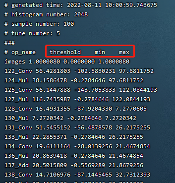

The following figure (Example of quantization parameters file) shows the final output of the calibration quantization parameters file
_images/cali_table.png
Fig. 7.2 Example of quantization parameters file

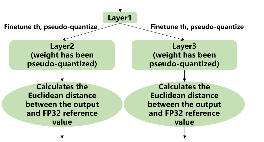

Implementation: firstly, uniformly pseudo-quantize layers with weights in the network, i.e., quantize their weights from fp32 to int8, and then de-quantize to fp32 for introducing quantization error. After that, tune the input activation quantization threshold of op one by one (i.e., uniformly select 10 candidates among the initial KLD quantization threshold and maximum absolute values of activations. Use these candidates to quantize fp32 reference activation values for introducing quantization error. Input op for fp32 calculation, calculating the Euclidean distance between the output and the fp32 reference activations. The candidate with a minimum Euclidean distance will be selected as the tuning threshold). For the case where the output of one op is connected to multiple subsequent ones, the quantization thresholds are calculated for the multiple branches according to the above method, and then the larger one is taken. For instance, the output of layer1 will be adjusted for layer2 and layer3 respectively as shown in the figure (Implementation of auto-tune).
_images/auto_tune_en.png
Fig. 7.4 Implementation of auto-tune

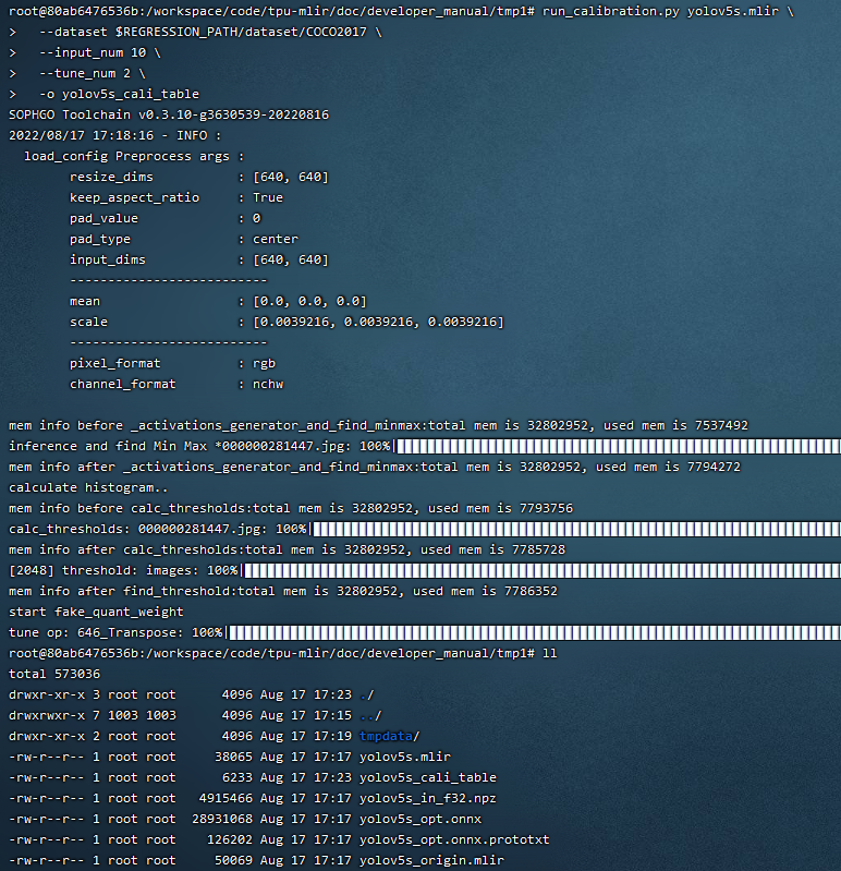

7.4. Example: yolov5s calibration
In the docker environment of tpu-mlir, execute source envsetup.sh in the tpu-mlir directory to initialize the environment, then enter any new directory and execute the following command to complete the calibration process for yolov5s.
 1$ model_transform.py \
 2   --model_name yolov5s \
 3   --model_def  ${REGRESSION_PATH}/model/yolov5s.onnx \
 4   --input_shapes [[1,3,640,640]] \
 5   --keep_aspect_ratio \  #keep_aspect_ratio、mean、scale、pixel_format are preprocessing arguments
 6   --mean 0.0,0.0,0.0 \
 7   --scale 0.0039216,0.0039216,0.0039216 \
 8   --pixel_format rgb \
 9   --output_names 350,498,646 \
10   --test_input ${REGRESSION_PATH}/image/dog.jpg \
11   --test_result yolov5s_top_outputs.npz \
12   --mlir yolov5s.mlir
13
14$ run_calibration.py yolov5s.mlir \
15   --dataset $REGRESSION_PATH/dataset/COCO2017 \
16   --input_num 100 \
17   --tune_num 10 \
18   -o yolov5s_cali_table
The result is shown in the following figure (yolov5s_cali calibration result).
_images/yolov5s_cali.jpg
Fig. 7.5 yolov5s_cali calibration result

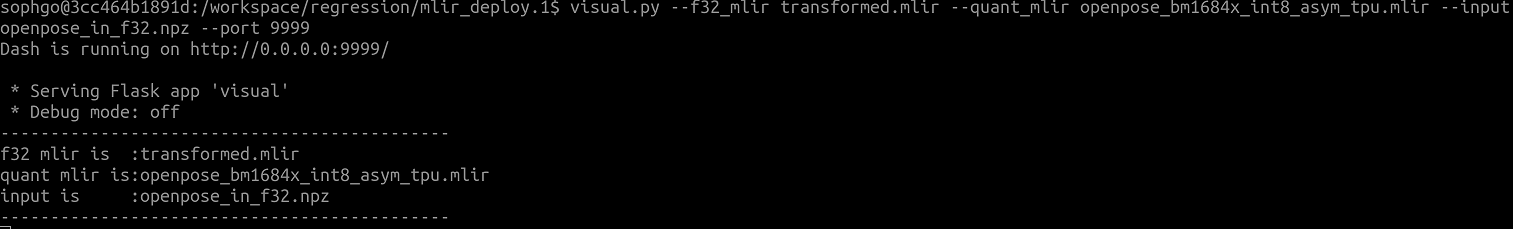

visual.py is an visualized net/tensor compare tool with UI in web browser. When quantized net encounters great accuracy decrease, this tool can be used to investigate the accuracy loss layer by layer. This tool is started in docker as an server listening to TCP port 10000 (default), and by input localhost:10000 in url of browser in host computer, the tool UI will be displayed in it, the port must be mapped to host in advance when starting the docker, and the tool must be start in the same directory where the mlir files located, start command is as following:
_images/visual_cmd.png
Open browser in host computer and input localhost:9999, the tool UI will be displayed. The float and quantized net will automatically inference to get output of every layer, if the nets are huge, it would took a long time to wait! UI is as following:

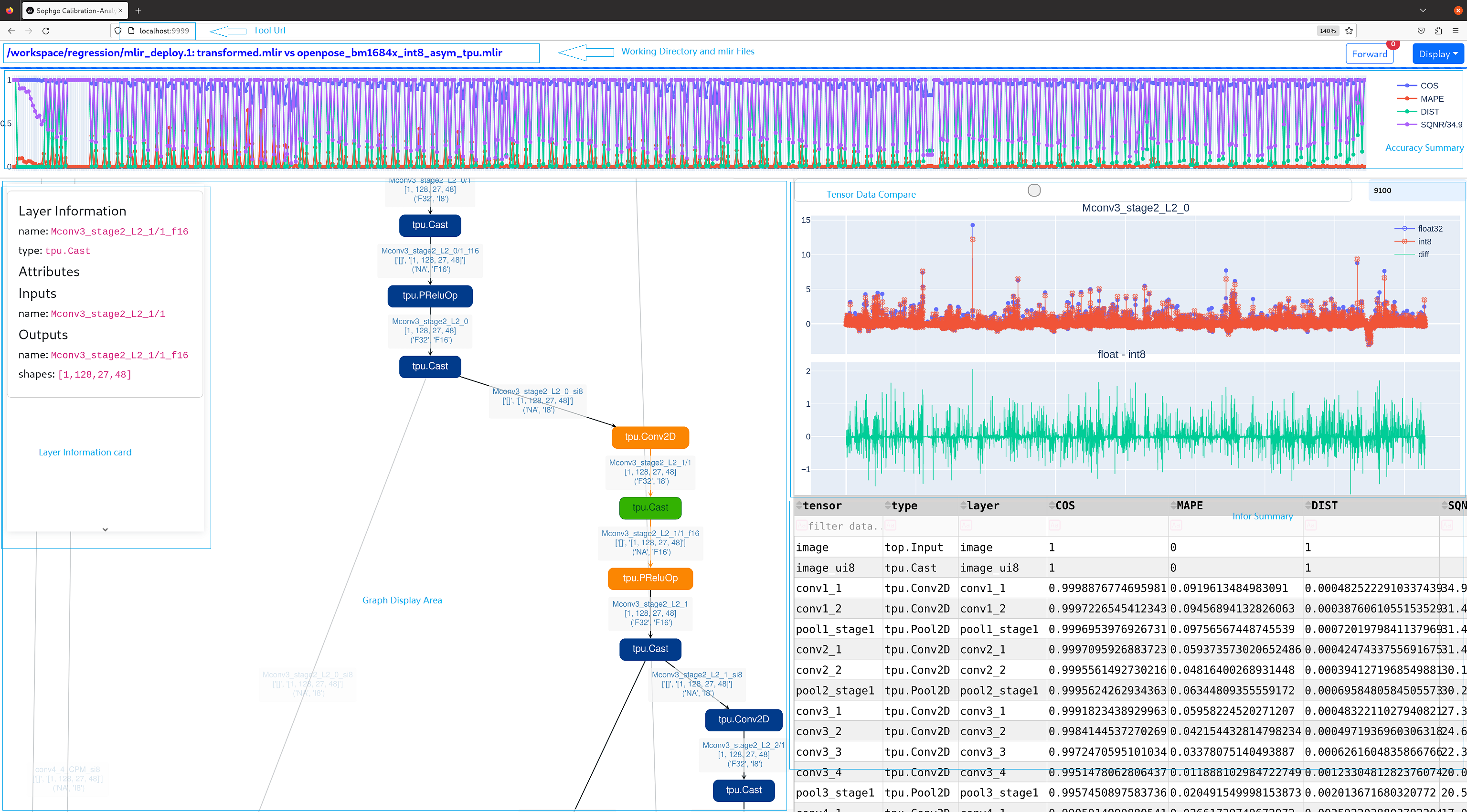

_images/visual_interface1.png
Areas of the UI is marked with light blue rectangle for reference, includeing:
  1. working directory and net file indication
  2. accuracy summary
  3. layer information card
  4. graph display area
  5. tensor data compare figure
  6. infomation summary
With scroll wheel over graph display area, the displayed net graph can be zoomed in and out, and hover or click on the nodes (layer), the attributes of it will be displayed in the layer information card, by clicking on the edges (tensor), the compare of tensor data in float and quantized net is displayed in tensor data compare figure, and by clicking on the dot in accuracy summary or information list cells, the layer/tensor will be located in graph display area.

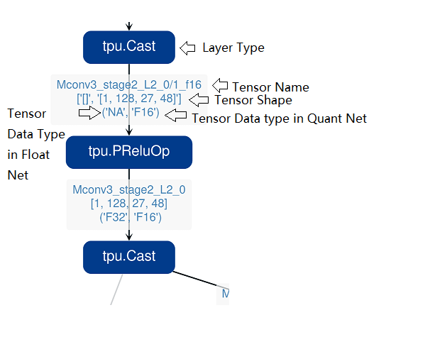

Notice: the net graph is displayed according to quantized net, and there may be difference in it comparing to float net, some layer/tensor may not exist in float net, but the data is copied from quantized net for compare, so the accuracy may seem perfect, but in fact, it should be ignored. Typical layer is Cast layer in quantized net, in following picture, the non-exist tensor data type will be NA.
information displayed on edge (tensor) is illustrated as following:
_images/visual_tensor.png
