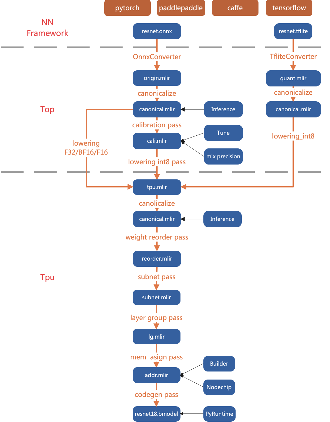

TPU-MLIR treats the compilation process of the network model in two layers.
Top Dialect
Chip-independent layer, including graph optimization, quantization and inference, etc.
Tpu Dialect
Chip-related layer, including weight reordering, operator slicing, address assignment, inference, etc.
The overall flow is shown in the (TPU-MLIR overall process) diagram, where the model is gradually converted into final instructions by Passes. Here is a detailed description of what functions each Pass does in the Top layer and the Tpu layer. The following chapters will explain the key points of each Pass in detail.
_images/flow.png
Fig. 4.1 TPU-MLIR overall process
