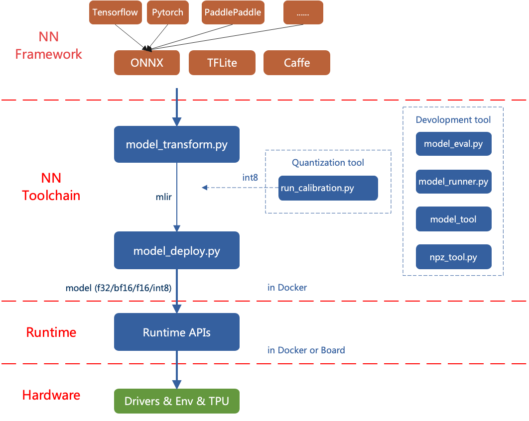

The overall architecture of TPU-MLIR is shown in the figure (TPU-MLIR overall architecture).
_images/framework.png
Fig. 1.1 TPU-MLIR overall architecture
The current directly supported frameworks are tflite, onnx and caffe. Models from other frameworks need to be converted to onnx models. The method of converting models from other frameworks to onnx can be found on the onnx official website: https://github.com/onnx/tutorials.
To convert a model, firstly you need to execute it in the specified docker. With the required environment, conversion work can be done in two steps, converting the original model to mlir file by model_transform.py and converting the mlir file to bmodel by model_deploy.py. To obtain an INT8 model, you need to call run_calibration.py to generate a quantization table and pass it to model_deploy.py. This article mainly introduces the process of this model conversion.
