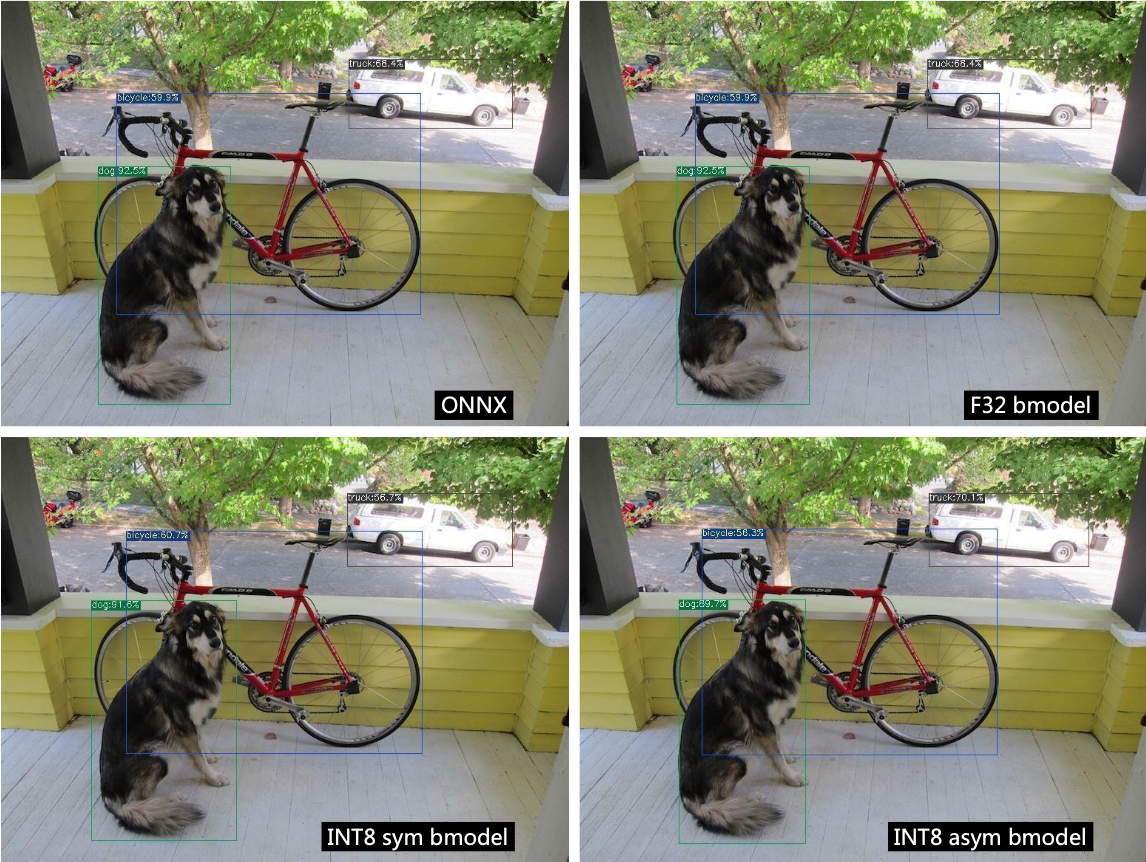

3.6. Effect comparison
There is a yolov5 use case written in python in this release package for object detection on images. The source code path is $TPUC_ROOT/python/samples/detect_yolov5.py
. It can be learned how the model is used by reading the code. Firstly, preprocess to get the model’s input, then do inference to get the output, and finally do post-processing.
Use the following codes to validate the inference results of onnx/f32/int8 respectively.
$ detect_yolov5.py \
--model yolov5s_1684x_f32.bmodel \
--model yolov5s_1684x_int8_asym.bmodel \
The four images are compared as shown in the figure (Comparison of TPU-MLIR for YOLOv5s’ compilation effect).
Fig. 3.1 Comparison of TPU-MLIR for YOLOv5s’ compilation effect
Due to different operating environments, the final performance will be somewhat different from Fig. 3.1.
