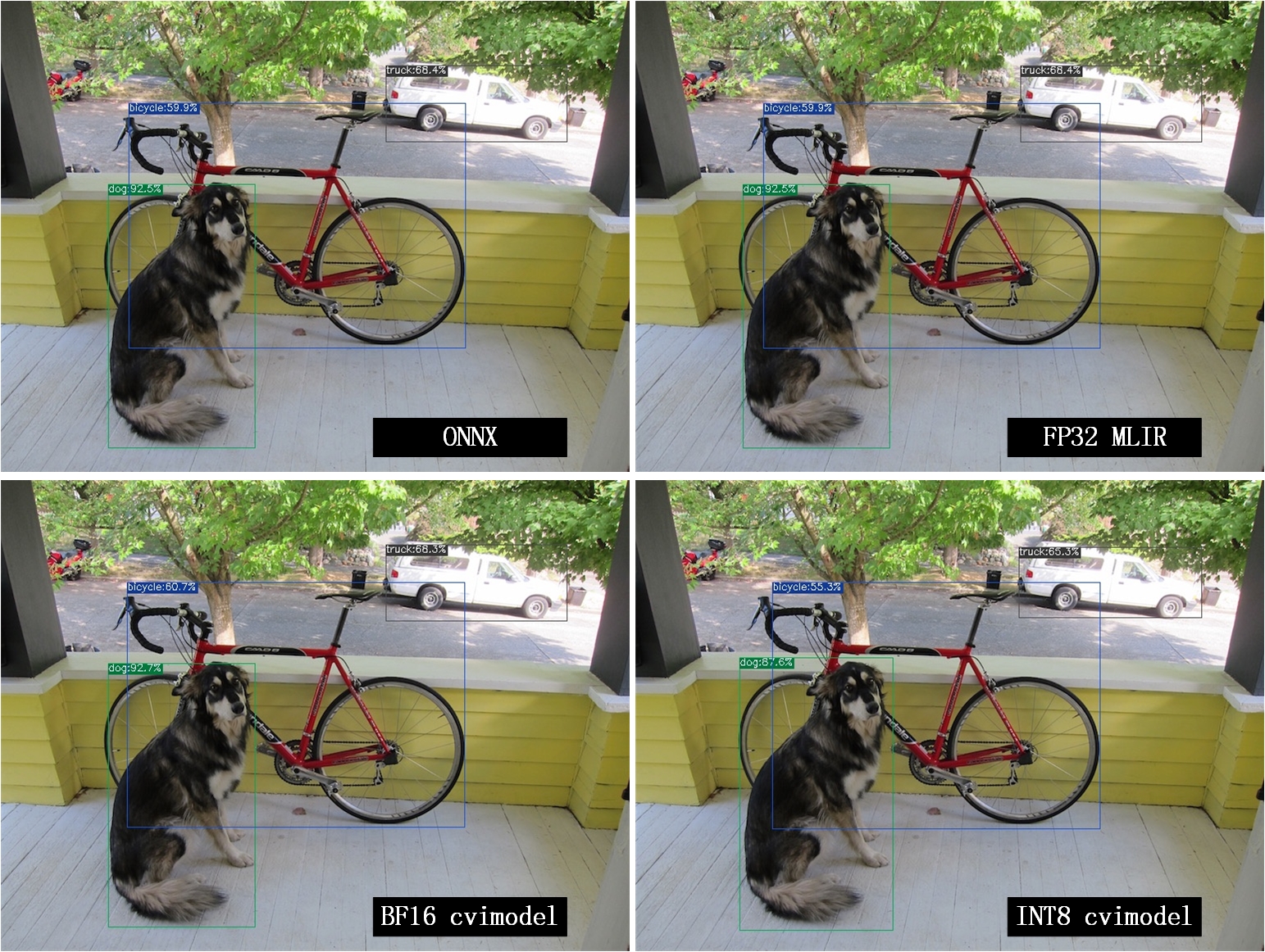

9.1.6. Result Comparison
$ detect_yolov5.py \
--model yolov5s.mlir \
--model yolov5s_cv183x_bf16.cvimodel \
--model yolov5s_cv183x_int8_sym.cvimodel \
The comparison of the four images is shown in Fig. 9.1, due to the different operating environments, the final effect and accuracy will be slightly different from Fig. 9.1.
Fig. 9.1 Comparing the results of different models
