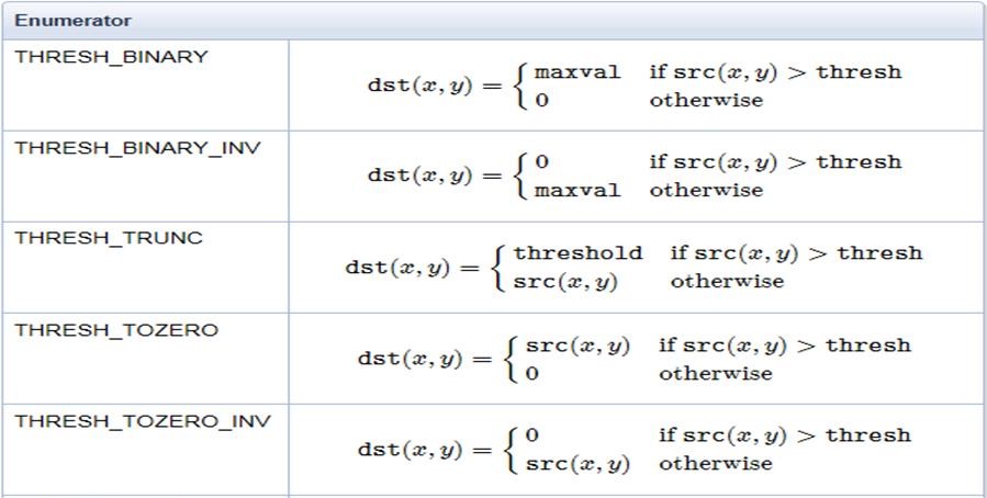

bm_status_t bmcv_image_threshold( bm_handle_t handle, bm_image input, bm_image output, unsigned char thresh, unsigned char max_value, bm_thresh_type_t type);其中thresh类型如下:
typedef enum { BM_THRESH_BINARY = 0, BM_THRESH_BINARY_INV, BM_THRESH_TRUNC, BM_THRESH_TOZERO, BM_THRESH_TOZERO_INV, BM_THRESH_TYPE_MAX } bm_thresh_type_t;各个类型对应的具体公式如下:
参数说明:
