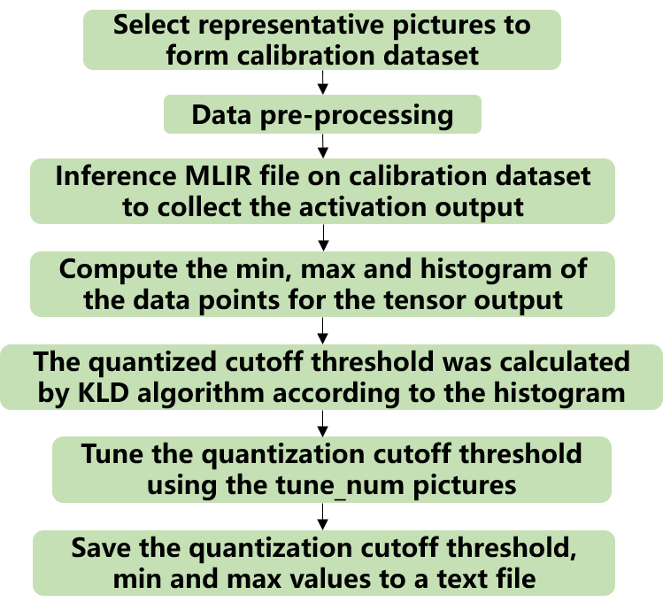

Calibration is the use of real scene data to tune the proper quantization parameters. Why do we need calibration? When we perform asymmetric quantization of the activation, we need to know the overall dynamic range, i.e., the minmax value, in advance. When applying symmetric quantization to activations, we need to use a suitable quantization threshold algorithm to calculate the quantization threshold based on the overall data distribution of the activation. However, the general trained model does not have the activation statistics. Therefore, both of them need to inference on a miniature sub-training set to collect the output activation of each layer. Then aggregate them to obtain the overall minmax and histogram of the data point distribution. The appropriate symmetric quantization threshold is obtained based on algorithms such as KLD. Finally, the auto-tune algorithm will be enabled to tune the quantization threshold of the input activation of a certain int8 layer by making use of the Euclidean distance between the output activation of int8 and fp32 layers. The above processes are integrated together and executed in unison. The optimized threshold and min/max values for each op are saved in a text file for quantization parameters. Int8 quantization can be achieved by using this text file in model_deploy.py. The overall process is shown in the figure (Overall process of quantization).
_images/cali_process_en.png
Fig. 7.1 Overall process of quantization

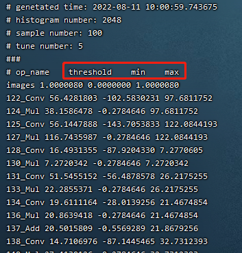

The following figure (Example of quantization parameters file) shows the final output of the calibration quantization parameters file
_images/cali_table.png
Fig. 7.2 Example of quantization parameters file

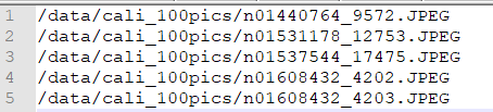

–data_list
Place the path of the image, npz or npy file of each sample (one sample per line) in a text file. If the network has more than one input file, separate them by commas (note that the npz file should have only 1 input path).
_images/data_list.png
Fig. 7.3 Example of data_list required format

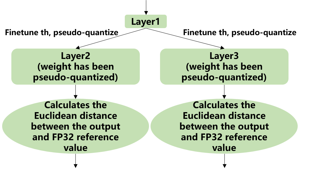

Implementation: firstly, uniformly pseudo-quantize layers with weights in the network, i.e., quantize their weights from fp32 to int8, and then de-quantize to fp32 for introducing quantization error. After that, tune the input activation quantization threshold of op one by one (i.e., uniformly select 10 candidates among the initial KLD quantization threshold and maximum absolute values of activations. Use these candidates to quantize fp32 reference activation values for introducing quantization error. Input op for fp32 calculation, calculating the Euclidean distance between the output and the fp32 reference activations. The candidate with a minimum Euclidean distance will be selected as the tuning threshold). For the case where the output of one op is connected to multiple subsequent ones, the quantization thresholds are calculated for the multiple branches according to the above method, and then the larger one is taken. For instance, the output of layer1 will be adjusted for layer2 and layer3 respectively as shown in the figure (Implementation of auto-tune).
_images/auto_tune_en.png
Fig. 7.4 Implementation of auto-tune

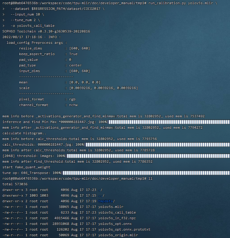

1$ run_calibration.py yolov5s.mlir \
2   --dataset $REGRESSION_PATH/dataset/COCO2017 \
3   --input_num 100 \
4   --tune_num 10 \
5   -o yolov5s_cali_table

The result is shown in the following figure (yolov5s_cali calibration result).
_images/yolov5s_cali.jpg
Fig. 7.5 yolov5s_cali calibration result

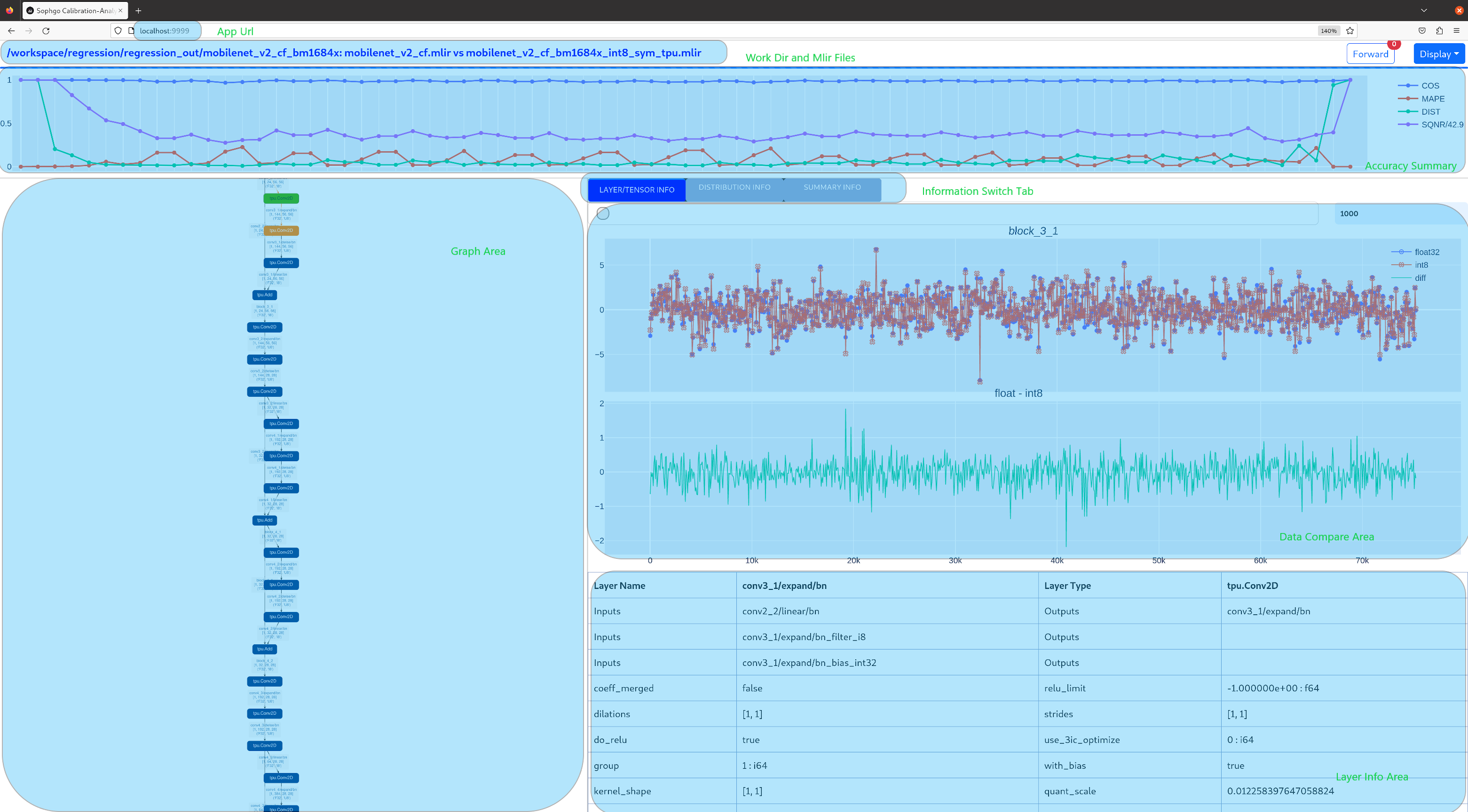

Open browser in host computer and input localhost:9999, the tool UI will be displayed. The float and quantized net will automatically inference to get output of every layer, if the nets are huge, it would took a long time to wait! UI is as following:
_images/visual_interface1.png
Areas of the UI is marked with light blue rectangle for reference, dark green comments on the areas, includeing:
  1. working directory and net file indication
  2. accuracy summary area
  3. layer information area
  4. graph display area
  5. tensor data compare figure area
  6. infomation summary and tensor distribution area (by switching tabs)
