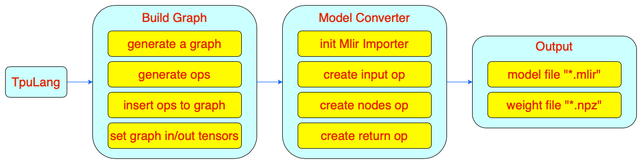

The workflow of TpuLang conversion is shown in the figure (TpuLang conversion process)。
Fig. 16.1 TpuLang conversion process

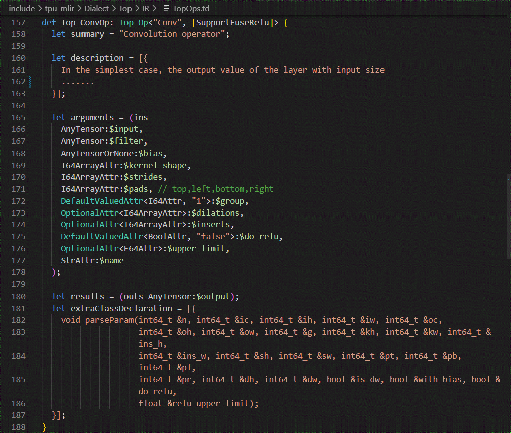

Define the Top.Conv operator in TopOps.td, the operator definition is as shown in the figure (Conv Operator Definition)
Fig. 16.2 Conv Operator Definition

attributes, pack the input parameters into attributes defined by (Conv Operator Definition)
attr = { "kernel_shape": ArrayAttr(weight.shape[2:]), "strides": ArrayAttr(stride), "dilations": ArrayAttr(dilation), "pads": ArrayAttr(pad), "do_relu": Attr(False, "bool"), "group": Attr(group) }Define output tensor

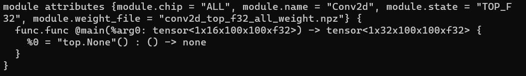

init_MLIRImporter:
Get the corresponding input_shape and output_shape from shapes according to input_names and output_names. Add model_name, and generate the initial mlir text MLIRImporter.mlir_module, as shown in the figure (Initial mlir text).
Fig. 16.3 Initial Mlir Text

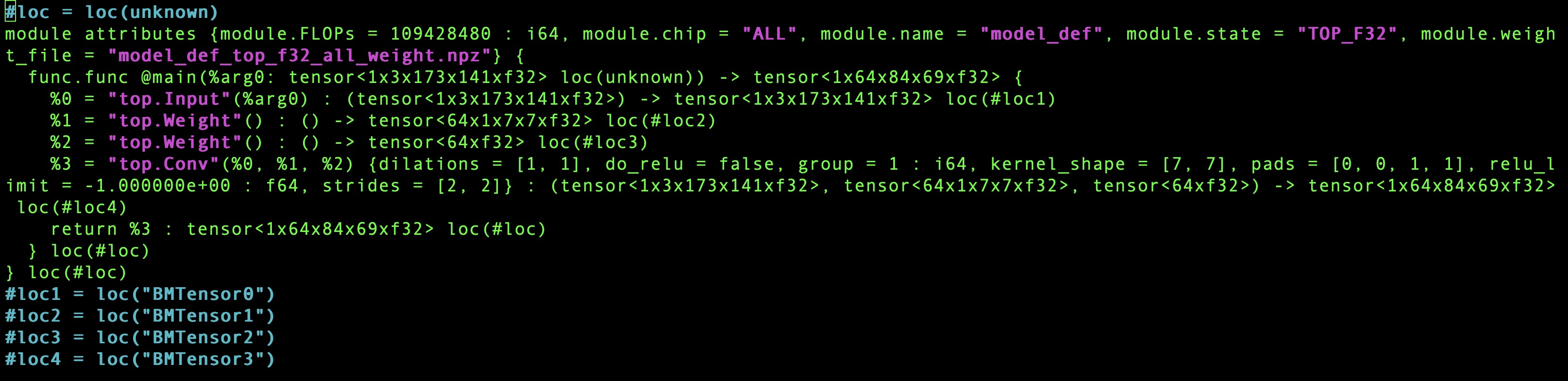

Get the corresponding op from operands according to output_names, create return_op and insert it into the mlir text. By this point, the generated mlir text is as shown (Full Mlir Text).
Fig. 16.4 Full Mlir Text
