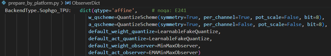

When the above interface selects the BM1690 chip, the default quantization configuration is as shown in the following figure:
_images/sophgo_tpu_default_para.png
The meanings of the quantization configuration items in the above figure, from top to bottom, are as follows:
1、The weight quantization scheme is: per-chan symmetric 8bit quantization, the scale coefficient is not power-of-2, but arbitrary
2、The activation quantization scheme is per-layer symmetric 8bit quantization
3/4、The weights and activation pseudo-quantization schemes are: LearnableFakeQuantize, namely LSQ algorithm
5/6、The dynamic range statistics and scale calculation scheme of weights are as follows: MinMaxObserver, and the activation is EMAMinMaxObserver with moving average

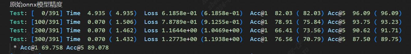

The command output log above contains the following(Original onnx model accuracy) accuracy information of the original model (it can be compared with the accuracy on the official webpage to confirm the correct training environment, such as the official nominal name:Acc@1 69.76 Acc@5 89.08,The link is:https://pytorch.apachecn.org/#/docs/1.0/torchvision_models):
_images/ori_onnx_acc.png
Fig. 15.1 Original onnx model accuracy

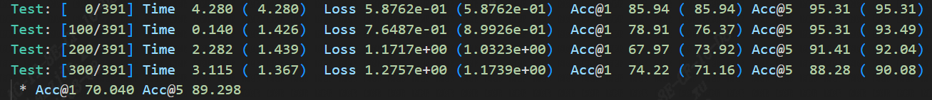

After completing the qat training, the eval accuracy of the running band quantization node, theoretically the int8 accuracy of the tpu-mlir should be exactly aligned with this, as shown in the figure(resnet18 qat training accuracy) below:
_images/r18_qat_train_acc.png
Fig. 15.2 resnet18 qat training accuracy

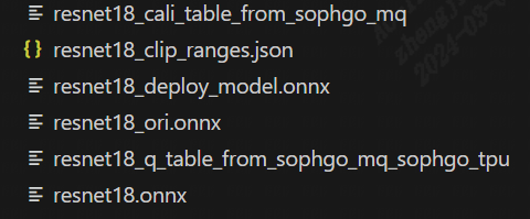

The final output directory is as follows(resnet18 qat training output model directory):
_images/r18_qat_output_dir.png
Fig. 15.3 resnet18 qat training output model directory

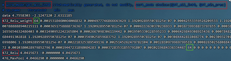

The resnet18_ori.onnx in the figure above is the original pytorch model transferred onnx file. This resnet18_ori.onnx is quantified by PTQ with the tpu-mlir tool chain, and its symmetry and asymmetry quantization accuracy are measured as the baseline and resnet18_cali_table_from_sophgo_mq is the exported quantization parameter file with the following contents(resnet18 Sample qat quantization parameter table):
_images/r18_qat_cali_table.png
Fig. 15.4 resnet18 Sample qat quantization parameter table
a、In the red box of the first row in the figure above, work_mode is QAT_all_int8, indicating int8 quantization of the whole network. It can be selected from [QAT_all_int8, QAT_mix_prec], and quantization parameters such as symmetry and asymmetry will also be included。
b、In the figure above, 472_Relu_weight represents the QAT-tuned scale and zp parameters of conv weight. The first 64 represents the scale followed by 64, and the second 64 represents the zp followed by 64.tpu-mlir imports the weight_scale attribute of the top weight. If this attribute exists in the int8 lowering time, it is directly used. When it does not, it is recalculated according to the maximum lowering value。
c、In the case of asymmetric quantization, min and max above are calculated according to the scale, zp, qmin and qmax tuned by the activated qat. threshold is calculated according to the activated scale in the case of symmetric quantization, and both are not valid at the same time。

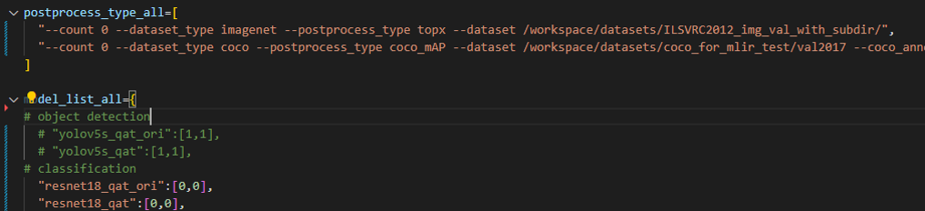

In the following figure, fill in more command strings of different precision evaluation methods in postprocess_type_all, such as the existing imagenet classification and coco detection precision calculation strings in the figure;In the following figure, model_list_all fills in the mapping of the model name to the parameter, for example:resnet18_qat’s [0,0], where the first parameter represents the first command string in postprocess_type_all, and the second parameter represents the first directory in qat_model_path (separated by commas):
_images/run_eval_param.png
After configuring the postprocess_type_all and model_list_all arrays as needed, execute the following run_eval.py command:
